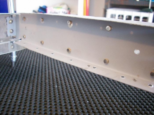

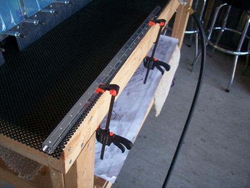

Match drilled the spar next to the trim tab to the skin. Deburred the holes and dimpled skin and bottom of the spar. I had to machine countersink the holes in the top of that spar so that the piano hinge will fit flush against it up underneath.
After that I decided to go ahead and rivet the skeleton together. I still need to work on the electric trim hole in the bottom of the elevator next but this way the skeleton is ready to go. I forgot that I would have to buck most of these rivets because of the double overhang of the ribs backed to each other. Oh well, it went very well. I think I am getting much better at bucking and riveting. Especially the 1/8" rivets. I didn't leave any more half moons like in previous attempts.
clamping down the spar for countersinking the holes on top

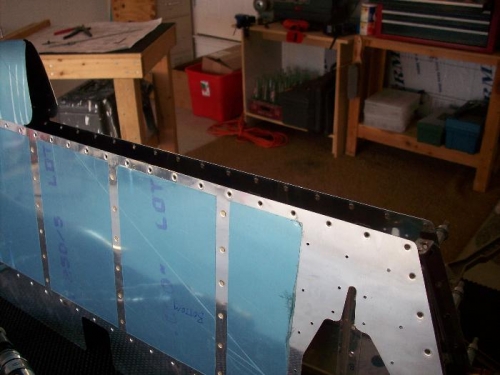

This is the area that the elevator trim tab will be in.  The electric trim motor mounts in the cutout
bucked these shopheads with the hammer shaped bucking bar
