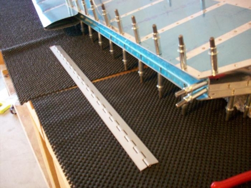

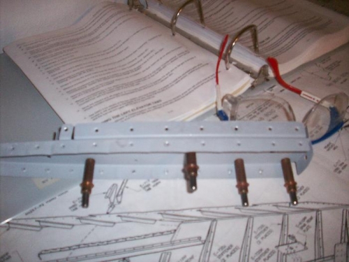

Match drilled end ribs on both sides of the Left Elevator. Deburred and Dimpled the holes. Used scotchbrite wheel to debur the E-705 and E605PP trim spar. Match drilled E705, deburred and dimpled. Resprayed some primer on the Counterbalance Ribs
Dimpled Counterbalance Ribs
Deburred End Skin and Rib
Getting Ready to Match Drill
