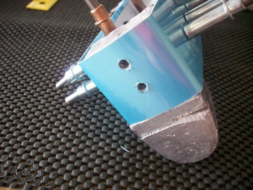

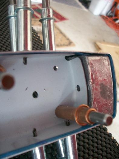

Removed some material from the counterweight to fit inside counterweight skin. Attached to ribs and fit counterweight skin. Drilled out 2 screw holes for securing counterweight at a later time.

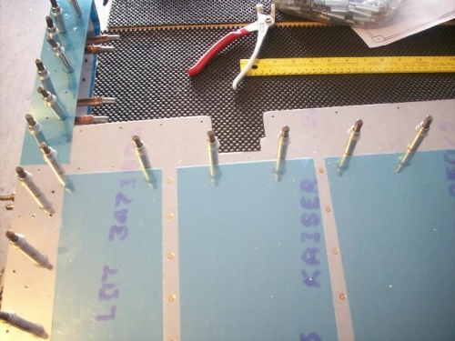

Assembled ribs and spar and clecoed into the skin for match drilling.
Match drilled skin to the ribs and spar. Removed and deburred skin.
Drilling Holes for Screws in Copunterweight
Counterweight Hole inside Rib
Match Drilling Rib and Spar
