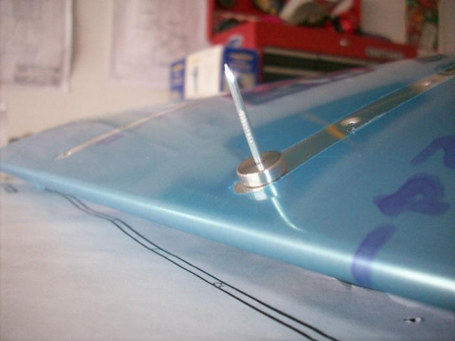

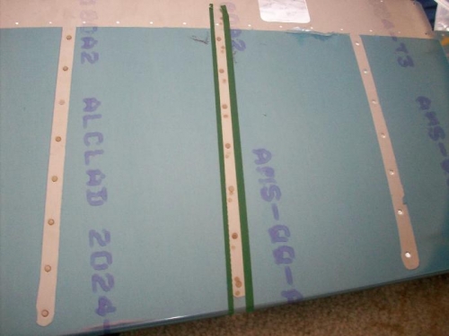

I removed strips of vinyl sheet with the soldering iron. Deburred holes in Left Elevator Skin with swivel deburring tool. Dimpled skin with squeezers where able and the rest with blind rivet dimple dies. Backriveted stiffners to elevator skin.

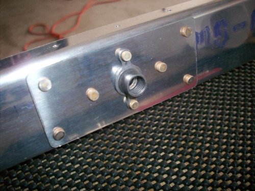

I then Deburred the rear spar with the die grinder. Also deburred the two doubler plates with die grinder. Match drilled doubler plates to back of stiffner. Riveted them in place with hand squeezer.

Pulling Blind Rivet Dimple Dies
Back Riveting Elevator Stiffners in Place
Riveting Reinforcement Plates to the Back of Spar
