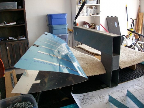

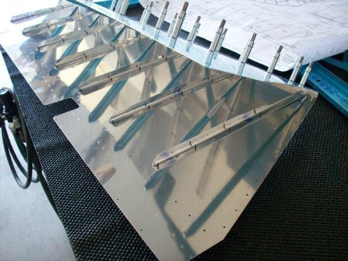

Manual Reference:  Trimming Stiffners
Brief Description:  R Elevator Stiffners

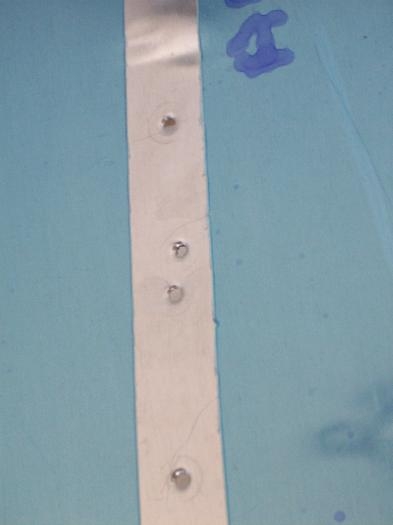

Finished cutting and preparing the Right Stiffners using band saw, files, scotchbrite wheel, and sandpaper roll. Match drilled them to Right elevator skin. Deburred holes. Dimpled stiffners and Skin with DRT-2. On one of the holes, the skin popped out of place as I was dimpling and punched an extra hole in the skin :(
