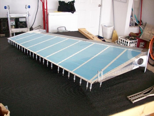

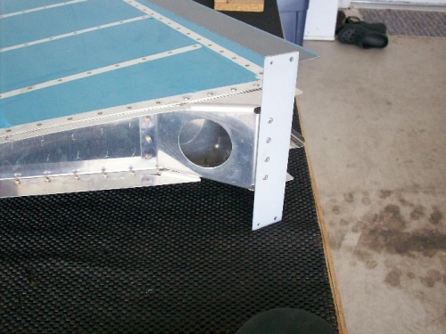

Rudder Skeleton
Fabricated the R-917 shim. Assembled skeleton. Fluted top rib slightly. Match drilled ribs, counterbalance skin. Cleco'd L&R skin to skeleton with the R916
