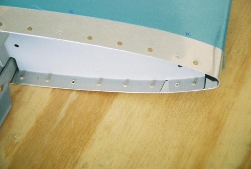

Riveting HS
Redimpling nose area
Had trouble dimpling the first couple of nose rib holes due to clearance. Ordered the blind rivet dimple dies from Avery. Worked like magic.
