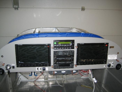

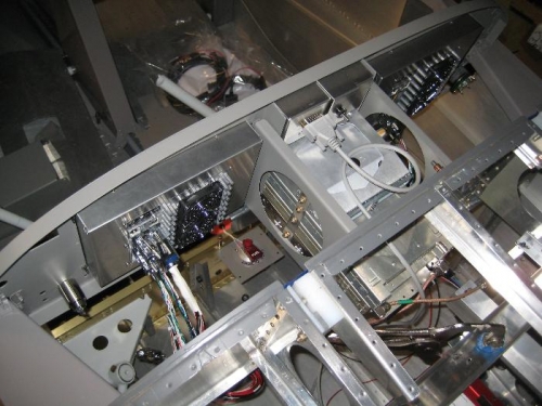

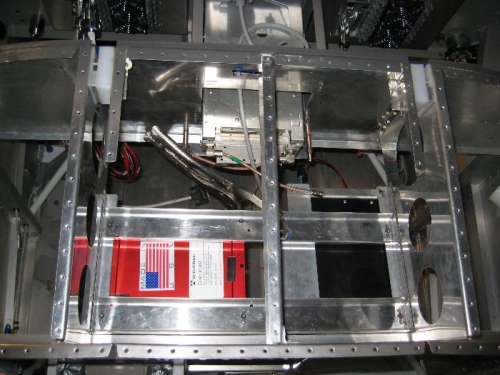

Brief Description:  Panel and Wiring
Painted the panel and started placement of the avionics. Electrical wiring involves building mounts for the multiple control units and wiring hubs. The trick is to build the shelves so they can be finally assembled from the bottom after the skin is riveted. Also, to place all the components so they can be connected and serviced from below.
Panel with paint
Panel with paint
Vertical Power c/u and G3i c/u
Top view of the panel/sub-panel
