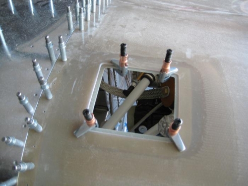

Layed out the oil door. The plans say to cut it minimum 4.5" x 5: so I made it 5x5. (Post comment - wish I'd made it much bigger) Since I got a good job on the cut, I didn't have to rely on the spare layup I did before starting. The piece actually came in handy for making the flange behind the oil door. It was a perfect profile so all I had to do was glass it into the opening.

Flange for the oil door to sit in

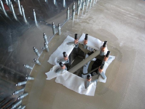

Flange epoxied in place w/parchment paper to keep cleco clamps from sticking
