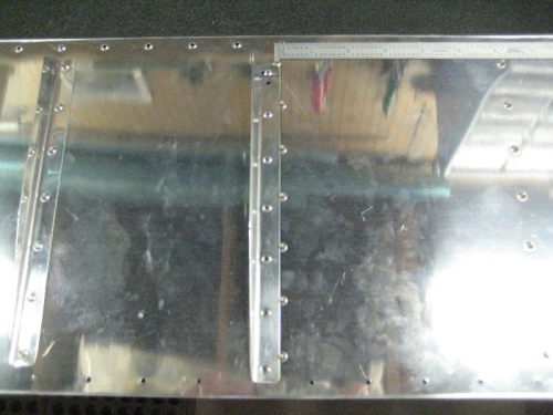

Brief Description:  Right Aileron
Finished preparation of parts for the right aileron. Back-riveted the stiffeners on the bottom skin and began the top skin. Found there was a problem with hole alignment for three of the stiffeners and it requires a new skin to be mailed.
Top hole is about 5/32
Top hole is about 5/32" too far left on three stiffeners
