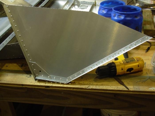

The next step is to rivet the rear channel in place. You're supposed to leave the rear wing attachments in clecos so that it's easier to rivet the side skins. You poke them through the opening and rivet them later. I was able to slide the fuselage halfway off the table in one direction then the other to get underneath and rivet this in place. As soon as I get the "boat" riveted together completely, I'm going to reconfigure my tabe to make it shorter. By "reconfigure" I mean I'm going to saw the legs off so it's just over knee-high. After the rear channel was riveted in place, I started on the entire seatback section that will be assembled, then riveted in place. I got as far as the arm rest before it was time for a sandwich.
Note that the wing attachment are NOT riveted yet. Wait on those.
