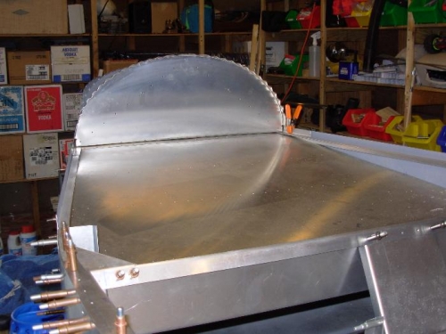

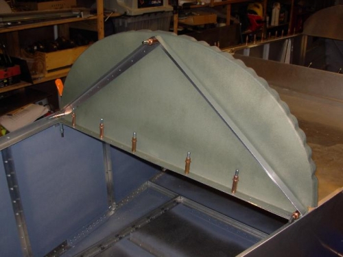

I worked yesterday and today on forming the final bulkhead - the baggage back. When I was considering making the changes to make this plane a 650, this bulkhead wasn't necessary. After deciding to finish it as a 601, I needed the bulkhead again! I made a set of forms - just like I've done for every other formed piece and hammered over the flanges. It looks good. I'm pleased with the way it all turned out.
L-angles used to stiffen the bulkhead
The bulkhead clecoed in place
From the back
From the back
