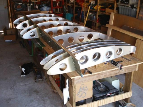

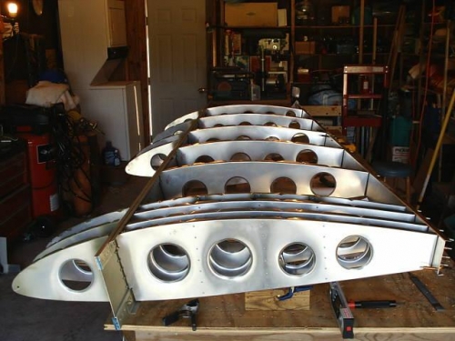

Brief Description:  Right Wing Skeleton Pilot-Drilling
Another busy day at Cox Industrial Smoothing (a not-so-vague Seinfeld reference). I spent most of the day getting the correct parts where they're supposed to be, and pilot-drilling them into place. As per the photo manual, I did the rear ribs first, then the nose ribs, then finally the rear channel. I had to take time out to fabricate the root doubler and hinge doubler, but that didn't take long. I'm actually very pleased with the way this is all turning out so far. All of the parts seem to have the correct dimensions to make it all work out nicely. I guess I shouldn't be surprised, but somehow I always am when things work out like they're supposed to. Just to be sure, I went out and meaured my wing tank to make sure it will fit in the space between ribs 3 and 4. Perfect.
Right wing skeleton pilot-drilled
Rear spar attached to ribs
Another view of the whole works
