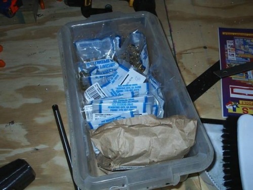

Brief Description:  Hardware and Rivet Setter Received
I ordered a bunch of hardware from Aircraft Spruce to finish up my wing spars (and other parts.) Also received the c-frame riveter from Avery Tools. That thing is a work of art - very nice. I experimented with using a small hand sledge and had good results, then I tried my air chisel with the regulator set all the way open on the included air riveter set. Wow. Beautifully set, square, perfect solid rivets with one or two squeezes of the trigger. Scares the hell out of the cat, but there will only be a month or so of this, so she'll get over it.
Box of aircraft hardware

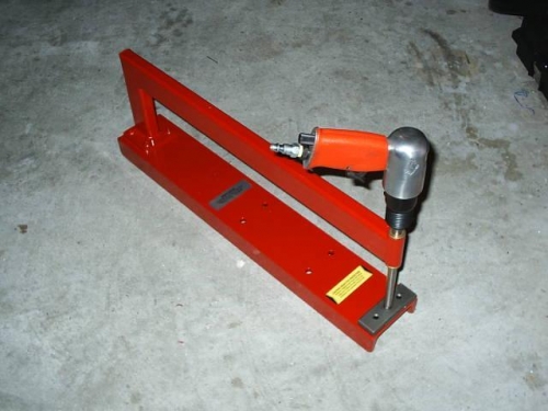

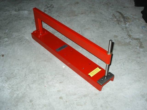

Avery c-frame rivet setter w/hand set
Air gun set - oh yeah
