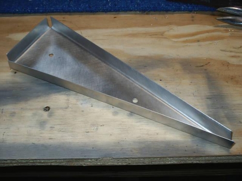

Sent a couple of hours finishing up the flap ribs. I've found that using the forming block approach as opposed to the bending brake approach for these is better. Each rib comes out identical to the other. These turned out really well.
Formed, scuffed-up, and ready for corrosion protection

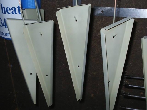

Corrosion protection drying

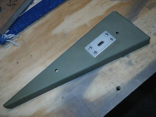

Flap control rod reinforcement for rib #1
