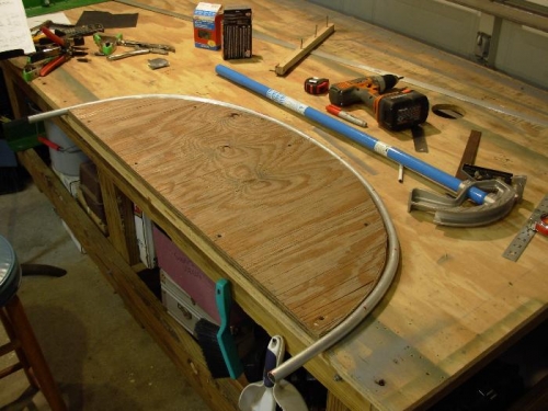

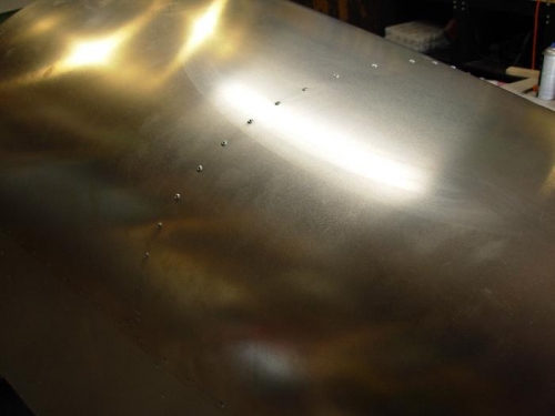

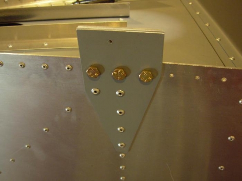

Moving forward, I started bending the fuselage hoops today. I wasn't exactly sure how to proceed, so I started out by making a form block to fit the inside dimensions outlined on the plans. By screwing the block to the table, I was able to use a couple of other secured blocks to bend the hoop into its approximate shape around the block. There was a lot of springback, so I used my conduit bender to tweak here and there until it fit the form perfectly. On another note, I was really unhappy with the amount of puckering that happened when I riveted the top rear skin into place. It was one of those things that I KNEW was gonna eat at me, so I had to fix it. I drilled out the rivets that were puckering and fabricated some .040 shims to go under the skin. The shims are 20mm x 20mm and have an A4-size hole in them. I slid one under each drilled-out hole and re-riveted. Boom. No puckering. You can see the result in the pic below. Now I can finally sleep. The last pic shows another view of the front horizontal stabilizer shim fix described in the last log.
The rear hoop bent to fit its form
Now THAT'S smooth
Now THAT'S smooth
Another shot of the front stab mount
