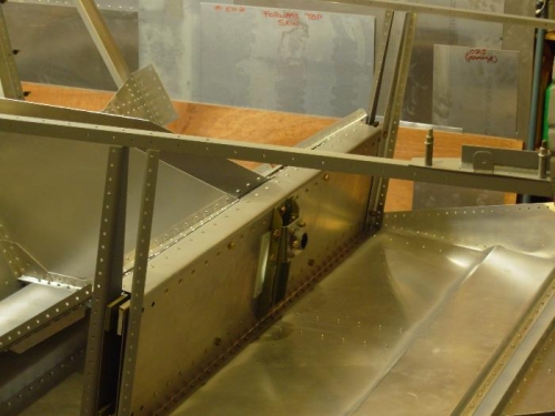

Brief Description:  Spar Uprights In Place
This afternoon I double-checked the fit and finish of the spar uprights. After deburring and painting them, I put them in place using bolts as registration pins for skin riveting. After another good deburring session on all of the skin attachment points, it'll be time to put the skins in place and rivet them.
Spar uprights in place
