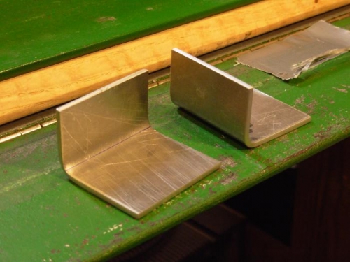

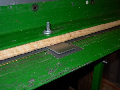

I decided to work on what I thought would be difficult to get to with much more construction - the rear channel and flap mechanism. There are quite a few details I needed to catch up on in this area including some "L" angles I need to cut and place. I never made my flap arm brackets, so I did that today. You actually have to measure where to make the holes while the bracket is held in place. Email me if you want to know more - it's a fairly involved process. The beefy brake worked like a charm for bending these - piece of cake. After locating and cutting out the flap arm holes in the rear skins, I inserted the flap arms and started locating the brackets on the rear spar. I got one done before calling it a day. I'll post pics of the completed assembly tomorrow. It's time for a nap.
The 1/8
The 1/8" bracket in the beefy brake
Nothing to these with the right tool
