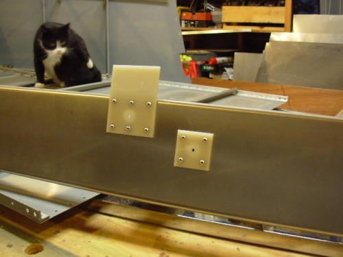

Date:  11-28-2008
Number of Hours:  2.50
Manual Reference:  6B
Brief Description:  Rear Channel & Seat Back Fairleads
This morning I finished up the cable fairleads I was working on last night. since I'm riveting the rear channel in place it makes sense to finish up all of the details on each piece as I go forward. Nothing particularly difficult about these other than a wrong dimension on the plans. The bottom hole on the larger fairlead should be 40mm from the inboard edge of the part, not 55mm as shown in my plans. They might have fixed this by now, I'm working off an older set.
Them some fine lookin' fairleads...

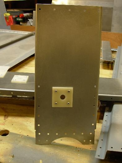

This one is on the seat back
