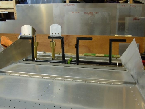

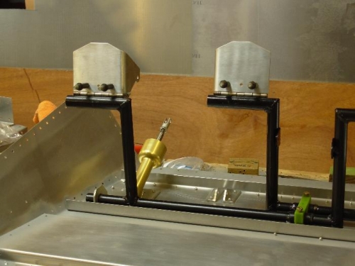

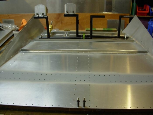

The rudder pedals and toe brakes have been surprisingly difficult to put in. There's just a lot of details, and the whole "bending the hinge around the tube" part is a little trickier than it looks. You may have noticed that I don't have the bolts welded to the rudder pedals yet. I actually forgot to weld the bolts before I painted them. Now there are a couple of problems - welding fumes from burning paint and fumes from welding cadmium-plated bolts. I may call Zenith and see if I can just bolt them without welding them. We'll see.
Checking everything for fit
A very ingenius design
Getting there... almost done
