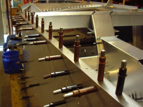

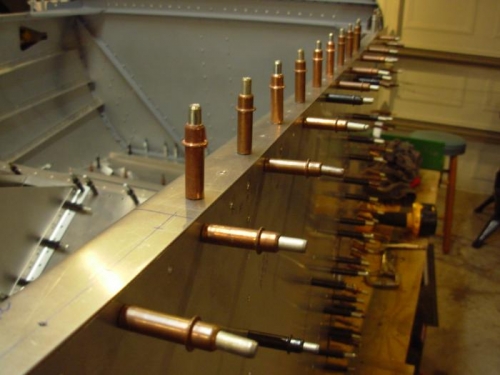

Brief Description:  Passenger Side Top Longeron Doubler
Another fun job. This little piece gives the top of the fuselage a nice, finished look. It hides the top longeron and all of the angles that terminate there nicely. I trimmed it close with my avaiation snips, then sanded it closer on the top belt of the bench sander, thenused a file to make final tweaks. The curve came out nicely, and fits perfectly on top of the longeron. Next I'll do the pilot's side.
The longeron doubler
The turned-down flange gives it a nice finished look
Looking from the rear - nice fit
