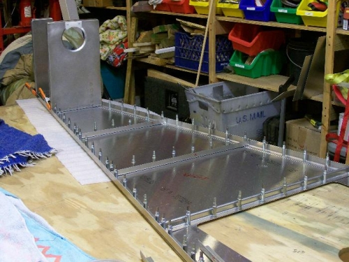

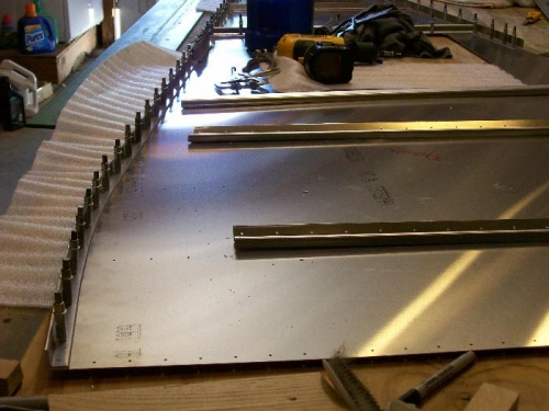

I finished up the right side fuselage bottom longeron this afternoon. Using the Larry MacFarland method, I was able to slowly bend the angle into a perfect fit using the skin as a template. Just go very slowly and make small adjustments. It'll work out. Next I'll do the left side. I'll try to get some pics of my bending jig too.
Rear longerons in place

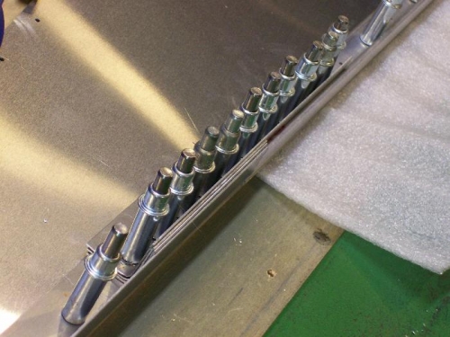

The splice (Two .040 angles as shims)
The bent angle. Piece of cake.
