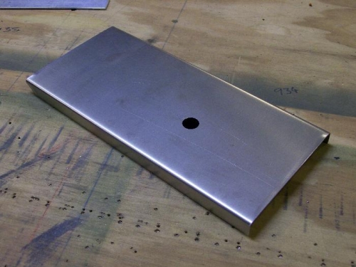

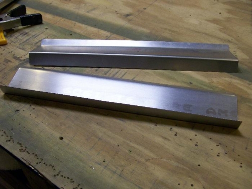

More parts! I think this pretty much finishes up the .032 parts for now. I still need to bend a few of the parts and flange holes, etc, but the majority of the work is done on them. I began shearing my longerons out of .040. These are fairly long cuts (1940mm), so I'm being very careful and taking my time. The plans call for a developed length of 42mm. I'm shearing mine to 82mm to leave an extra flange on each side to be trimmed away. This helps the brake get a grip, and also strengthens the flange during bending so they come out nice and straight. It leaves me with a little scrap, but MUCH easier than farming these parts out to be bent, or paying outrageous shipping to buy them from ZAC.
These go on either side of the canopy
This will eventually be trimmed a little more to fit
