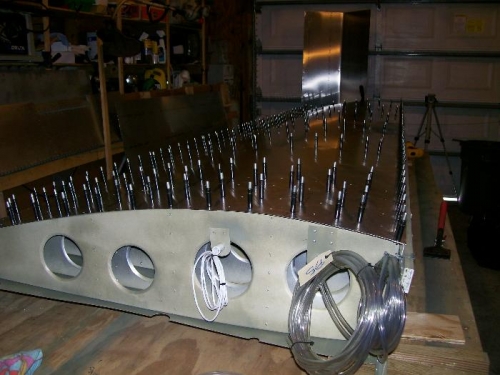

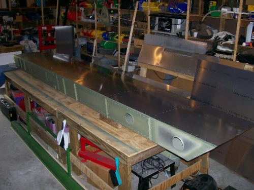

After tinkering with my finger screen access door, I ran to the auto parts store for a can of my favorite self-etching primer so I could fog the interior of the wing skin. After doing that, I did a final very careful leveling and clecoed everything in place for riveting. I hand-pulled about half of the rivets for that feeling of satisfaction that only hand riveting can bring, then used my pneumatic gun for the rest. I'm all set to start atttaching my fitted leading edge now. Shouldn't take long from here until this wing goes on the rack for storage.

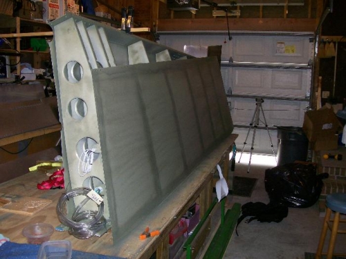

The interior of the skin fogged for corrosion protection
