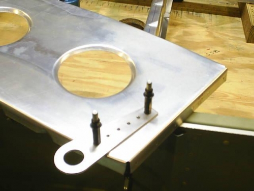

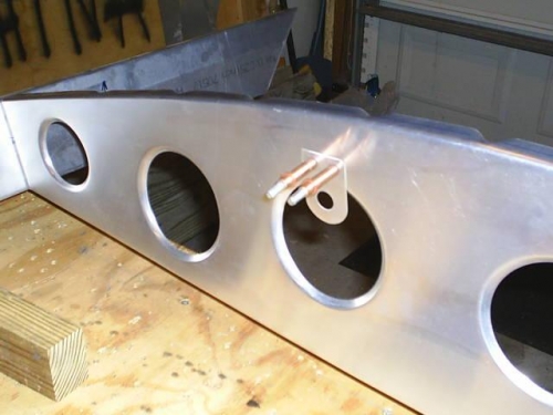

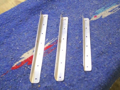

Since I'm out of corrosion protection paint and it's Thanksgiving holiday, I'm moving forward and taking care of some of the wing skeleton details. I fabricated stiffener angles yesterday and placed them on ribs 1-4 for the wing-walk. This morning I attached the outboard tiedown and began placing conduit brackets. I think I've pretty much decided to put the pitot/static tubes and the LRI probe on the same (left) side. The pitot/static will go on rib #5, and the LRI probe will go on rib #6. I'm running a second, shorter piece of conduit to run the plumbing through. There will be a lot going on in this wing - nav/strobe wiring, aileron trim wiring, pitot/static plumbing, and LRI plumbing.
Left tiedown placement
Wing-walk stiffeners for ribs 1-4
Conduit brackets
Conduit brackets
