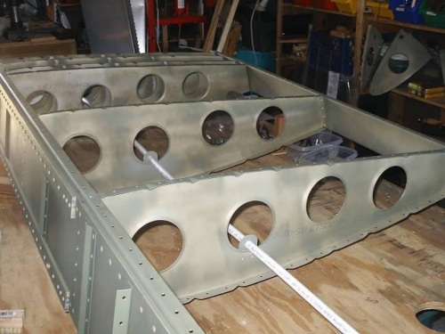

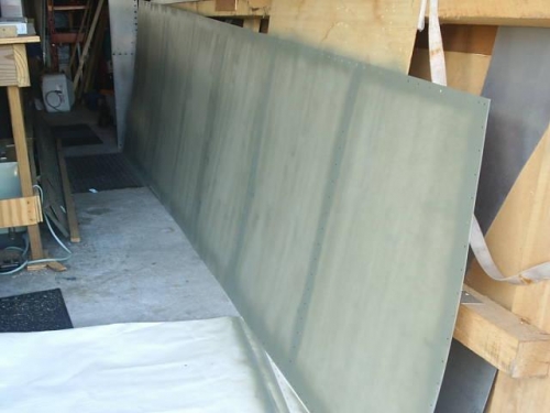

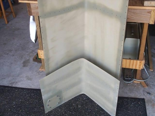

Brief Description:  Top wing Skin Prepped for Final Riveting
I spent a little less than an hour today getting the top skin ready for final riveting. As far as I can tell, it's ready to go on permanently. Tomorrow I'll do the bottom skin. I need to get some more paint. At this point, the entire internal structure will have been at least fogged with zinc chromate primer. Some people may consider this overkill, but remember that I live on the Outer Banks of North Carolina. My house is one block from the Atlantic Ocean, and the airport is about 4 miles away. Hopefully my nephew will be flying this plane long after I'm gone. This is getting exciting. I expect to be totally done with this wing by the end of next week.
Top wing skin fogged w/zinc chromate
Leading edge skins - same
Internal ribs fogged too
