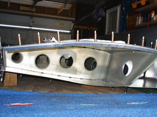

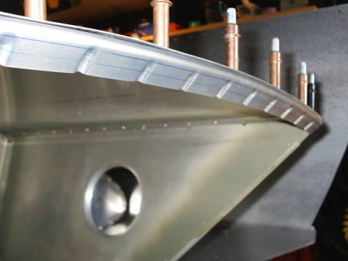

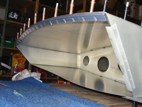

I don't mind telling you that there are some things that I look at on the plans of this project and ask myself "How am I ever going to do that?" This compound curve wingtip flange was one of them. I understand the theory of how it should work, I just didn't know if I could make it happen. Well Brothers and Sisters, I'm here to tell you that it ain't that bad. The top flange you see here took me about an hour and a half, and I was being extremely careful. It's a fairly simple matter to put crimps every 40mm and get the curve you want. I have a good pair of Avery crimping pliers which I'm sure made it go more smoothly that if I hadn't had them, but even with my home-made crimping pliers, I feel reasonably sure I could have gotten the same results. The lesson? Stop frettin' and start bending. It almost always looks more difficult than it is.
Top wingtip flange in place
Tip of the wing
Tip of the wing
Flange showing tangent line and rivet line
