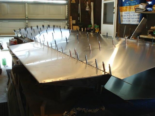

Brief Description:  Aileron Attachment and Top Skin Deburring
This morning I attached the right aileron to the wing. Since my little snafu with the flap, I drilled the hinge with the aileron in place and it worked beautifully. I spent the rest of the time removing clecos from the top skin and deburring. I'll be tweaking the rib flanges to 90-degree angles to eliminate the skin puckering you see in the pics.
Temporarily in place
