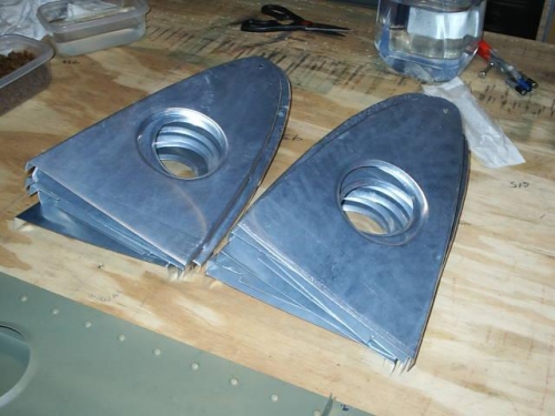

Brief Description:  Nose Ribs Completed
I finished up my nose ribs this evening. I now have 14 nice-looking ribs ready for installation. Next step is working on my rear rib form blocks. I ended up re-making 2 of the ribs that I wasn't happy with. Scratchbuilders - here's what I learned. 1.) Be very careful about getting the crimps too close to the web of the rib. You can make a nasty crease where the crimp meets the web if you're not very careful. 2.) Make sure you have no more than 4mm of metal extending past the nose, or it will wrinkle as you're bending the tight nose radius. 4mm works out perfectly.
14 finished nose ribs
