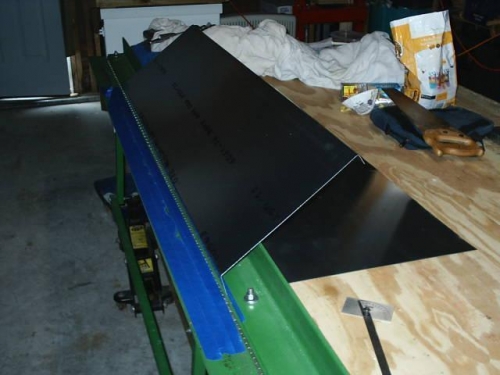

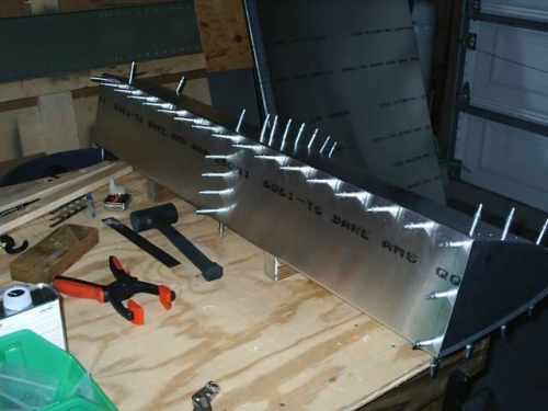

Today I bent my first tank skin and did preliminary assembly to see how it will all go together. I was very careful to measure and calculate the bends so that I'd have a tight-fitting skin in relation to the ends. All my work paid off. The skin fits the ends very tightly - so tightly in fact that it's a bit of a bear to assemble. I wrestled with the center baffle for quite a while to get it to sit squarely inside. Since riveted tanks are a departure from the plans, I'm following what I've seen others do, and making up the rest as I go along. By this point I pretty much know what I should about edge distances, pitch, etc. I'm satisfied with the results. When I'm done, I'll have two 15-gallon long-range tanks that I can be proud of. Next step is to start locating fittings including the gauge sender, tank vent, fuel cap, fuel drain, and fuel output to the engine.
Bending the tank skin
Tank end with clecos in place
Back of tank with clecos
