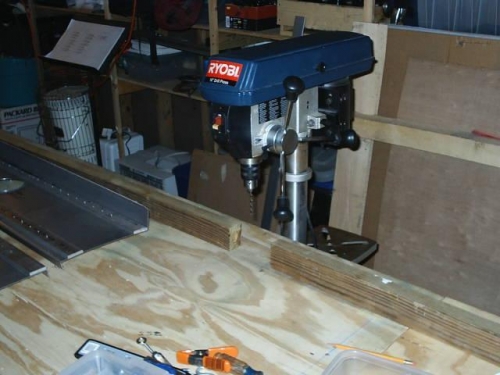

Brief Description:  Spar Cap Drilling Rig
Reconfigured my drill press to sit at the edge of my work table so I can drill the spar caps and spars. I spun the head on the drill press around so it would fit onto the table, and cut a couple of long blocks to keep the spar straight and level while drilling. I squared and secured the drill press to the table so it will drill exactly 90 degrees to the spar caps. I built the spacers to the height of the Avery rivet press, so I'll be able to use the same ones to rivet my spars when the time comes.
Spar cap drilling rig

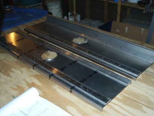

Center spars ready for drilling
