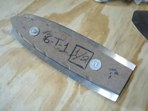

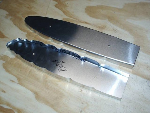

I formed my first parts today. These are the horizontal stablizer end ribs - fairly difficult parts to make because of the tight nose radius. I ended up scrapping the first one I made, chalking it up to the learning curve. These two turned out perfectly. I believe that this will be the end of the REALLY tight nose radius parts, so it should be all downhill from here! I bought the scratchbuilding video from homebuilthelp.com, and it was great. I probably would have had a much longer learning curve without the video. Thanks guys.

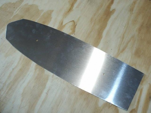

.025 part blank for the end rib
Blank clamped into forming block ready to be bent
Finished end ribs
Finished end ribs
