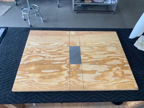

Brief Description:  Created a back riveting platform
Had a left over piece of 3/4 plywood from my work bench builds and used it to make a back riveting platform. With the excellent help from my hangar partner, Gary Emmerson, we marked and routed out for the back rivet plate to sit flush with the surface. Sanded smooth and gave it 2 coats of Danish Oil. Marked extended lines of the plate to assist lining up parts when riveting.Looks like it should work good. Though I wish I would have gotten a bigger plate.
Back riveting platform
