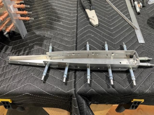

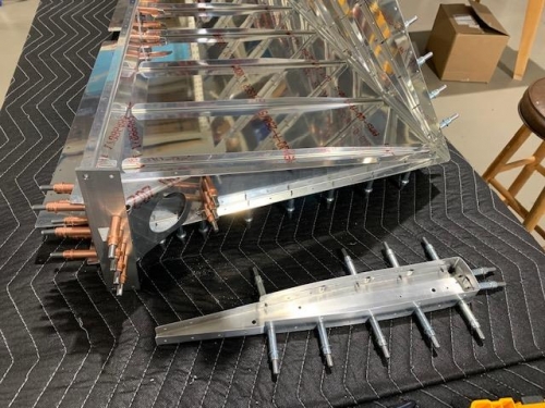

Brief Description:  Rudder Structure Buildup
Clecoed R-713 to R-703 and did additional fluting and forming flanges on R-703 to fit right and also align properly with skin. Matched drilled all holes on R-713 and R-703 along with R-801PP skin. Have gone off script with the plans here as trying to get all worked completed before priming and making the trailing edge bend. Match drilled all spar reinforcement plates with spar. Match drilled all R-710, R-405PD, R-704 parts and with R-802PP spar where applicable. Clecoed spar assembly to one side of the skin and matched drilled all holes.
