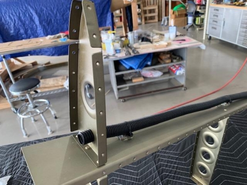

Vert stab work

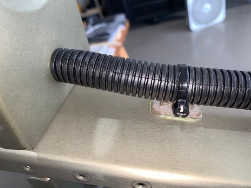

Ran the wiring conduit along front spar and secured with cable ties. Fed end runs of conduit through 11/32" holes in ribs. This locked the conduit in place with the corregations and trimmed ends. Very happy with this installation.
Wiring conduit
Top rib
Bottom rib
