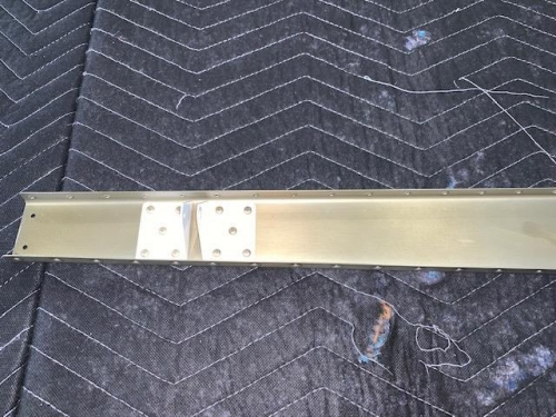

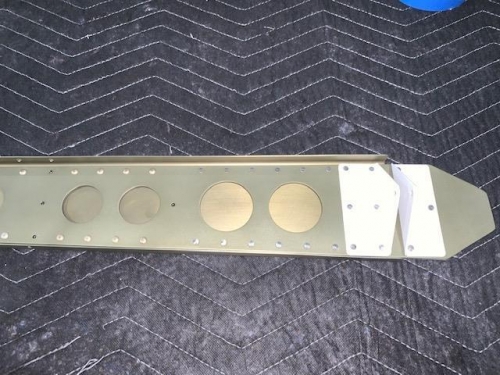

Vert stab rear spar build up
Riveted the VS-808 doubler and all rudder hinge brackets to VS-801 rear spar. Very happy with this rivteting job. Had to turn the air pressure uo to 100psi on compressor to get my squeezer to squeeze the -6 and -7 rivets properly.
