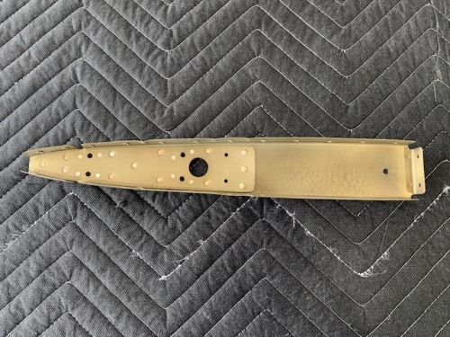

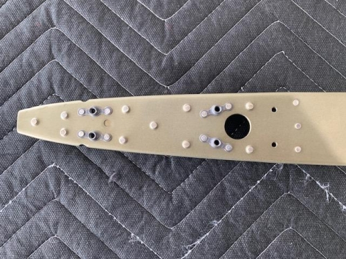

Build up of VS-706 doubler
Riveted the doubler plate and nut plates to VS-706 using AN426AD3-3.5 rivets for structure and NAS1097AD3-3.5 rivets to secure the nut plates.
