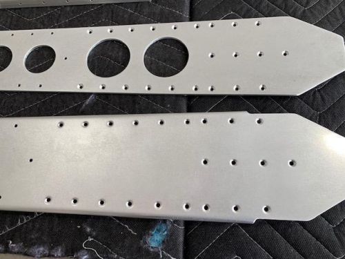

Brief Description:  Vert Stab work continued
Dimpled the lower holes on VS-803 to accept AN426 AD4 rivets. Countersunk cooresponding holes in VS-808 doubler to mathc the spar. Finished surface prepping all VS structure pieces with exception of the skin. Once the hnagar gest above 95 degrees on these hot days its time to call it quits.
Dimpling lower holes on VS-803 spar
Countersunk holes on VS-808 doubler

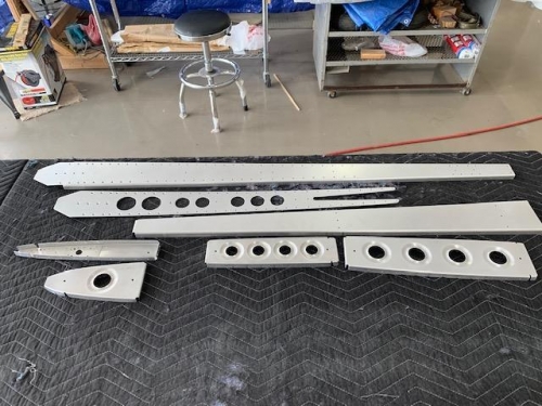

Surface prepped, ready for dimpling.
