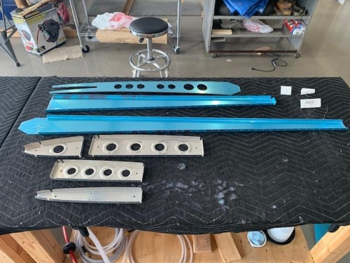

Brief Description:  Started work on vertical stab
Began work on the vertical stabilizer. Clecoed rear spar doubler to rear spar and added rudder hinge blocks. Edge prepped, straightened flanges and fluted all ribs and clecoed them in place. Match drilled all rear spar hardware and all rib connections to #30 hole using reamer.
Vertical stabilizer parts
All clecoed up
