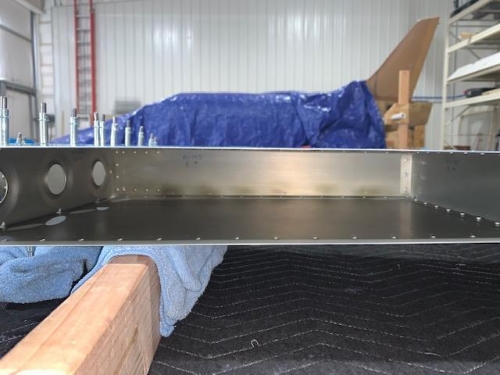

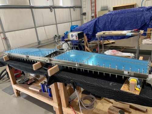

Prepped the scratches I created while riveting foward spar to skins. Mixed up a small batch of P60G2 and used an airbrush to prime the scratches on the forward spar. Actually worked pretty good and I'm happy with the results. Clecoed the rear spar into place and decided I need to make a stand or something to hold the rear spar vertically to finished riveting.
Prepped and airbrush primer on scratches
Ready to rivet rear spar to stab
