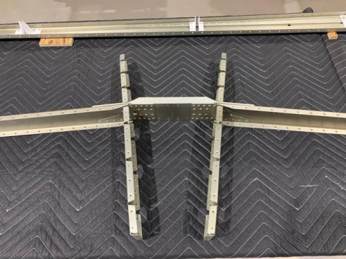

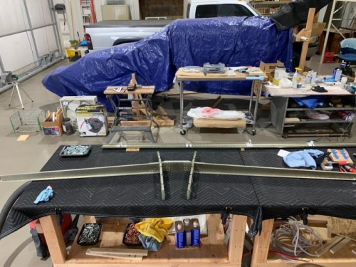

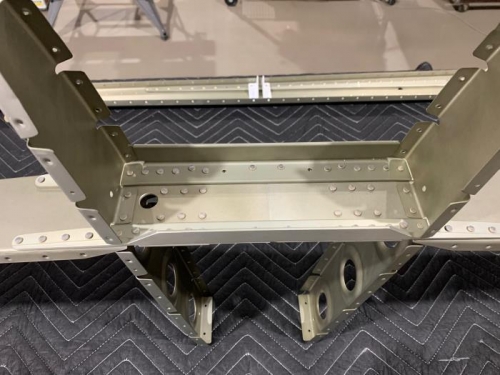

Finished up assembly of HS front spar by riveting inboard ribs in place. I'm happy with the end result. I turned up my compressor to 100 psi and squeezing the -6 and -7 rivets went much better than yesterday. Went back and hit the questionable rivets from yesterday and brought all within specs..
Front spar assembly complete
