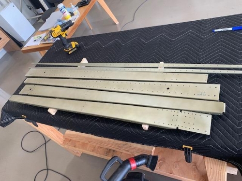

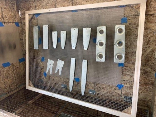

Did a final wipe down of all parts using isoproyl alcohol to remove any grease, smuges, fingerprints, etc. Hung the ribs and shot them with Sherwin Williiams P60G2 primer mixed 1:2. Hung the skins up in booth one at a time and shot them as well. Finished up by shooting the spars. For my first time spraying I feel fairly good about the results.Got a little heavy on a couple spots on the spars and the skins look a little spotchy but all in all, I feel everyting has nice coverage and as everyone on the forum has said, keep it light. Yeah, glad this first primer session is behind me. Next one will go much faster and smoother.
H.S. Ribs and Spar Doubler Primed
H.S. Spars Primed
H.S. Spars Primed
H.S. Parts Drying
H.S. Parts Drying
