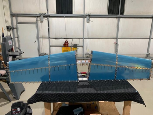

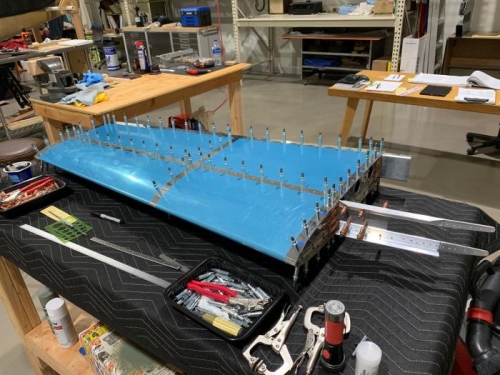

Finished the build up of Rt Stab. Removed skin and finished drilling all holes in HS-702 spar, HS-00003 and HS-810 and HS-814. Went well with no issues. Curiosity got the best of me and I had to cleco both halves together for a fit check. Cool, looks like a horizontal stabilizer. Next will be final prep, dimpling, priming and riveting all together. Time to get a spray booth set up as it was a whopping 15 degrees today. I have decided to go with the Sherwin Williams P60G2 primer. I don't thinkl I'll go wild over this process, just a good scuff of all parts with scotchbright and a wipe with Acetone and prime.
