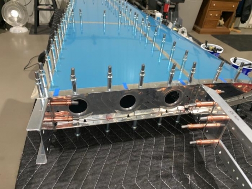

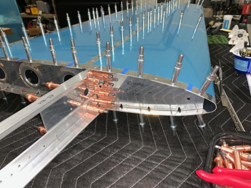

Brief Description:  Finished build up of left horizontal stab
Finished up working on inboard ribs HS-0005 and HS-0006. Clamped in place and match drilled ribs using skin as a guide. Measured and drilled 5/8" hole through Spar HS-702 and HS-00003 spar plate for manual elevator trim cable. I am installing electric trim and probably didn't need to drill this but did anyway incase things change in the future. Matched drilled holes in HS-702 spar from center rib inboard and then reamed to size remander of holes in the skin. Removed skin and finished drilling all remaining holes in HS-702 spar, HS-0003 plate, HS-810 and HS-814 reinforcing bars. Left stab build up complete on to the right side. Right stab buildup should go much quicker.
