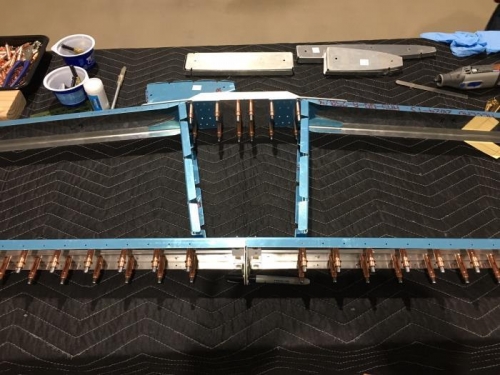

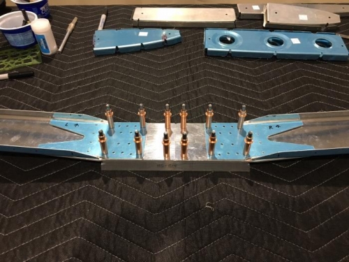

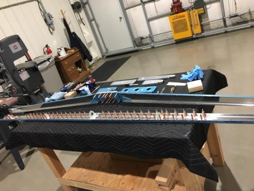

Continued work on H.S. front spar. Trimed inboard flanges on both HS-702 spars to clear inboard ribs. Cleaned up relief notches in spars a bit more. Made the bends in both spars. Very happy with bends as the spars, angle and splice pieces and reinforcement plates all match up well. Clecoed all together to check fit and had to lay rear spar along with front spar for a pic.
