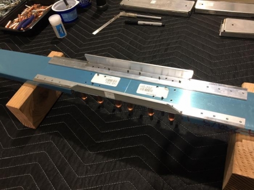

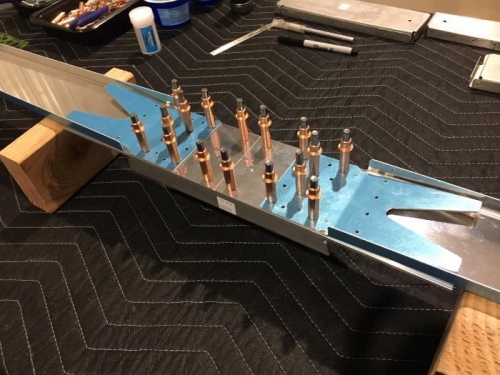

Brief Description:  Horizontal Stab Forward Spar
Started work on horizontal stab forward spar.Cutout and cleaned up HS-00003 spar doublers. Clecoed HS-810 and HS-814 reinforcerment angle and splice to spar. Instructions said to measure and clamp HS-00003 doublers into postion in the spar channels and then match drill the inboard holes. As it is, 2 stamped holes in each doubler, spar and angles matched which allowed me to cleco toghether and align things well. Match drilled inboard holes and all holes out to the spar bends. Next up bending the reinforcement angle, splice and spar.
