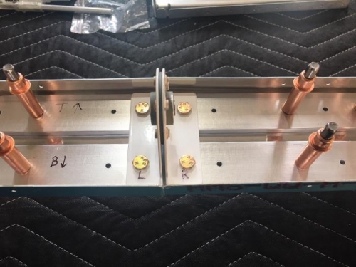

HS Rear Spar work
Clecoed completed bearing bracket to rear spar and drilled to size, #12, through the bracket, spar doubler and spar. Installed the mounting hardware.
Rear spar buildup complete. Moving on to HS Front Spar buildup.
