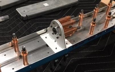

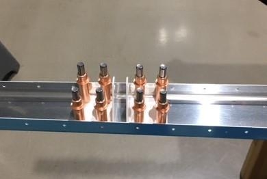

Rear Spar Work
Match drilled all holes on rear spar reinforcement bars. Clecoed elevator hinge brackets in place and match drilled. Assembeled center elevator hinge/bearing and match drilled left and right bracket thru bearing housing.
Elevator Hinge Brackets
Elevator Hinge Bearing Bracket
