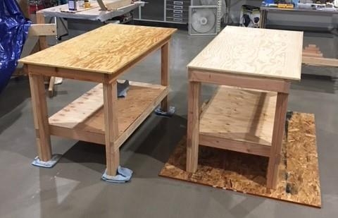

Brief Description:  EAA Work Benches
Built 2 EAA Workbenches. Modified to 60" x 30" tops with a 2 inch lip around the the front and left side of one and the front and right side of the other. The thought was to have a lip to clamp things down with but I can also butt the 2 tables end to end or back to back for larger work surfaces. Also put retractable wheels on both tables for ease of moving them around.
