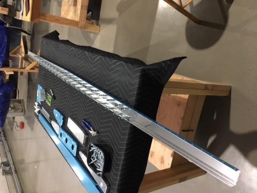

Date:  10-7-2018
Number of Hours:  3.00
Brief Description:  Rear Spar Prep
Prepped rear spar reinforcment bars by smoothing the sharp edgess that sit against the spar using scothbrite wheel. Rounded all 4 ends to 1/4" radius. Dressed both pieces to get rid of manufacuring marks with a Roloc disk in angle grinder and scotchbrite pad. Finally clecoed both reinforcment bars to rear spar.

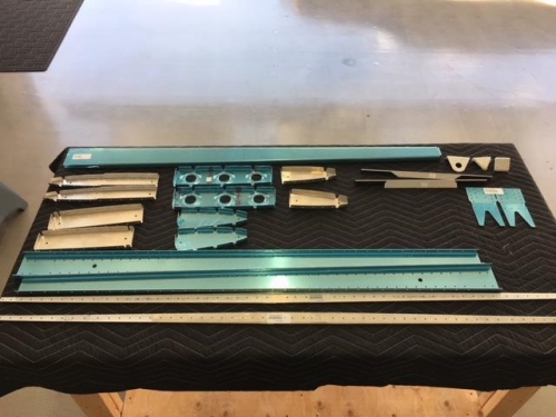

Horizontal Stab Parts
